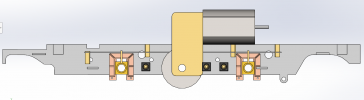

Simon, a few thoughts occur to me. The CSB can be "underslung" if more convenient. When choosing the pickup locations, remember the non-conductive "V" on the back of Slaters' wheels - perhaps have the rearmost pickup forward of the axle, etc?. The rear spacer/pony pivot needn't be a plain rectangle, you can cut a piece with an extended central "semicircle" to allow you to place the pivot in the required position, without interfering with the hornblocks. Cheers.

Further progress:
The chassis has been soaked in paint stripper and is now in the ultrasonic bath. Some bits did not survive, the Slater's pickup frame bushes, unfortunately. I can soon turn some new ones, but the irony was that the floating pickups on this loco were made from, and therefore the right size for, the Slater's bits. I could have made them much smaller. Tant pis, as they say en France. I have relocated the holes as you can see to bring the pickups all down to the lower part of the frames, to leave space for the spring wire.
I've used the CSB calculator from the CLAG website - the only difficulty at present is the CoG is too far aft (roughly the centre pickup), and I might weight the front of the loco to move it forwards a bit. The loco weighs a kilo, more or less.
My plan is to use brass angle soldered to the chassis to carry the wire - the wire itself is 0.48mm piano wire, which I have in stock.
I have allowed for the deflection which is expected to be 0.82mm.
I plan to modify the Slaters hornguides by running a 1.5mm milling cutter through the upper flange
and similarly, the axleboxes, by milling a slot
and then soldering in a piece of 1mm brass with a hole for the CSB.
a plea to @adrian, @Phil O @JimG and anyone else who has built one - have I missed anything or done anything daft, before I cut metal?
I also thought it would be quite easy to make the front and rear CSB mountings on the frames adjustable by means of a screw from below, which would offer the opportunity to trim the height and get the loco level if for any reason, it doesn't come out right. Is this worth doing?
cheers
Simon
thanks Paul,
I'd considered an underslung CSB, but the cast springs would likely be in the way. I think that moving the pick ups was the right way to go.
The V on the wheels shouldn't be a problem with a sprung six-wheel loco and DCC - at least I hope not, unless they all align at once! And they won't, I just checked, and they appear to be pretty random on the 6 wheels I have - four of them are to one side of the crankpin, one is the other side, and the sixth is ~180 degrees away!
Simon,
Is there enough meat in the rear frame stretcher to allow cutouts around the horn guides?
Probably not. The pony pivot is a rectangle with two lugs either end, which engage in matching holes in the frames. I may have to cut the rear one out, as I do not think the frames will come apart, they were soldered and screwed. I will build the Warren Shepherd cast pony trucks to check they are the same length as the Springside ones before committing myself, and then I can make a revised support to suit. It fitted on the real thing, so I'm confident I can make something suitable!
I might get one built before the Rugby starts...
cheers
Simon
PS, I won't get one built, they're rather nice castings and will need a little fettling before assembly - and they appear to be a couple of mm shorter than the Springside ones, which means the front might change too :(
