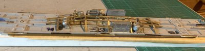

Back onto the build. The modified guards steps and the footboards in place.
A closeup showing how I've mounted the footboards and a closeup showing the guards step.
A photo showing the floor pan, you can make out the dynamo belt and the fitting for the brake pull rods.
I did have a bit of a problem when I test fitted the bogies in that they could catch the floor pan cut-out corners so out with the burrs and off came the corners.

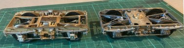

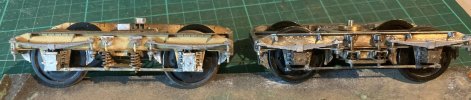

Hello all,
the bogies for Ian's JLTRT BG are about completed, apart from a clean and some paint along with the working springs.
So I thought that it would be nice to to do a photo compare of the JLTRT bogies and the D.J.P. bogies.
If I got the photos correct the D.J.P. bogies are always on the left.
Top view, the JLTRT needed to have a bush made with a collar to get the ride height correct on one of there own coaches? I still have to check the ride height of the JLTRT POS that the D.J.P. bogies are going under.
From the side.
From underneath.
From the end.
Both bogies have there pluses and minuses, JLTRT +speed of build, - Lack of detail. D.J.P. + The amount of detail , fit of parts. - Fitting the brake blocks onto the hangers.
The wheels are Slater's fully turned steel wheels (7138) in use on both bogies.
ATB
OzzyO.

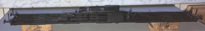

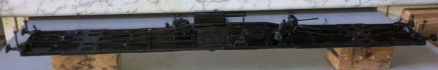

Hello all,
a test fit on the buffer beam for the Slater's dummy buckeye coupling that I'll be fitting to this coach. It looks pretty good.
Now to throw some paint on the thing.
Trying to get a good photo of a black underframe and see any detail is a bit on the hard side.
ATB
OzzyO.
