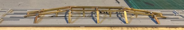

I started with the angle trusses and had the same problem with folding them as on the PoS. The brass is a bit thick at 18 thou but with a half-etched line and then scoring them it was out with the hammers again.
After the bending? I got this.
After I got it something like straight and flat it was onto some assembly.
Then fitting it to the floor pan, to get this.
A close up showing some of the bits that need a bit of work. I'm thing about adding some pins (or bits of brass wire) down the backs of the uprights to add more support for the truss.
