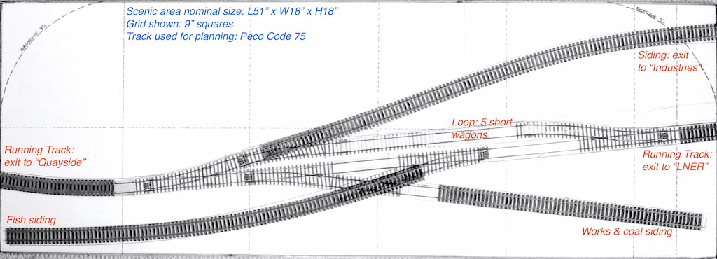

    Setting: LNER; mid-1930s; ex-NER Blyth & Tyne Rly area; urban/industrial setting; goods only
    The track-plan is relatively conventional but very compressed, with a short loop to enable shunting and three main destinations for wagons, one siding being reversed in relation to the others to add ‘interest’ to operations. Trains will be short, but I want to be able to run two locomotives at any one time, and employ a variety of traffic.
    The scenic board will be supplemented with three short, dismountable off-scene storage tracks, one at each end of the running track and one at the end of the long siding at the rear of the layout. It will also be possible to operate the layout in a limited way from the right-hand end only, if space is constrained.
    The track-plan and scenery are justified by an “imagined history” rooted in the actual history of its location. The real history is well researched, but elements of the imagined history are undoubtedly whimsical and may require the occasional suspension of disbelief. Both histories will be explained in other postings.
    It will be important (and sometimes challenging) to accept and manage the compromises necessary to meet the deadline; I shall use proprietary stock and kits where possible but build specifically local or defining items from scratch, adopting a theatre-like approach in which unseen parts of scenery are not modelled.

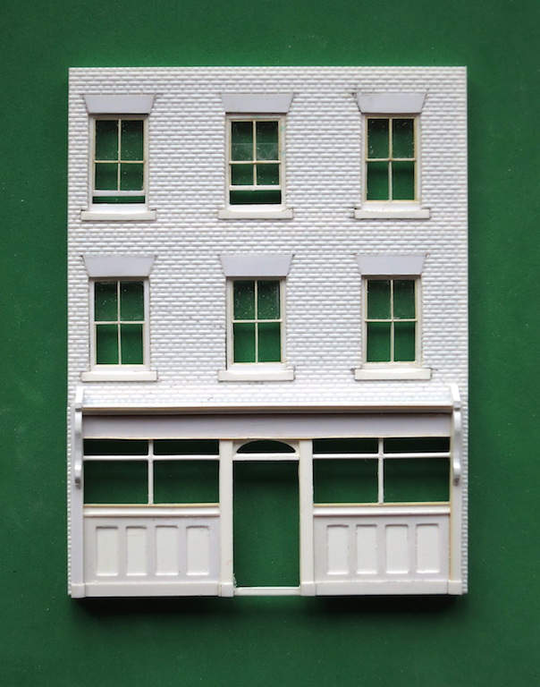

    This posting illustrates initial progress on one of the buildings overlooking The Low Quay Yard, and includes reflections on the process of making it.
    The building was chosen because it represents the late 18thC / early 19thC period of building along the Union Wharf at the foot of the riverbanks. I cannot date the building precisely; the earliest verifiable reference I have found lists it as an inn in 1834 but the building itself could be earlier than that. It remained an inn for the rest of its existence, and is modelled as it appeared in the 1930s.
    The photograph shows only the modelled front of the building, which will form one component in a range of buildings yet to be built. There are still details to add and most of the glazing, some low-relief interior detail, and the entire roof structure are yet to be modelled. The asymmetry is authentic.
    Because this is my first attempt at scratch-building in a couple of decades, I have regarded it as a practice piece and used it to re-learn a number of techniques and processes such as:

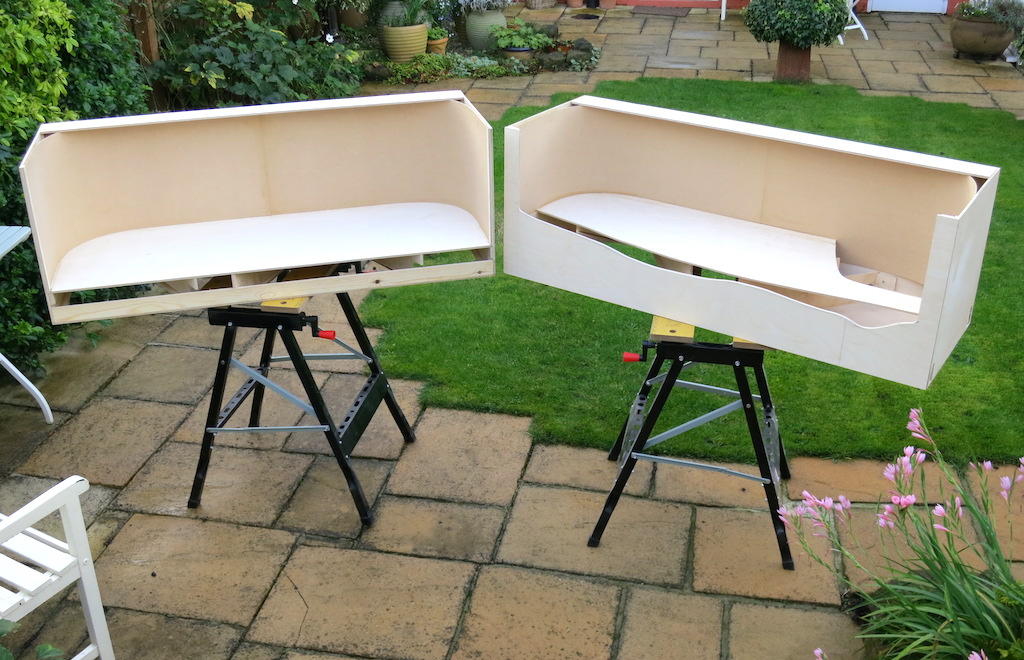

    Last week I spent a very happy three days with my friend of many years, Paul (the Squire of Old Parrock), working together to design and build our respective baseboards. Using the same general design concept and overall dimensions, we each produced the main frame of our baseboards, including the curved backscene. We used 6mm birch ply, 3mm MDF, and waterproof wood glue. Here are three photos of my board, and one showing the twin boards together.
    The first photograph shows my baseboard lying on its back to facilitate fitting the lower part of the fascia, showing how that was clamped up while the glue set. The ply baseplate of the structure stabilises the outer frame and the cross-members which give shape and stability to the structure. Inside the end of the frame at the right-hand end you can see the apertures for the drawer runners which will support the fiddle yards at each end.
    The following photograph shows my board with lower fascia fitted and the drawer-runners extended; these are asymmetrical, the right hand ones being 500mm long and the left 450mm - this is to fit the space I have available when the layout is in situ.
    Low Quay Fiddle Yard runners - with lower fascia fitted + both sides extended 01 copy for forum.jpg
    Finally, to show the very real benefits of active co-operation, here is a portrait of the two baseboards, Paul's and mine, together, illustrating the similarities of the design and the differences in detail reflecting our respective track and scenic plans. (When this photograph was taken my board was still without its lower fascia.) Paul's is the one on the right, with the more immediately interesting profile cut in the fascia.

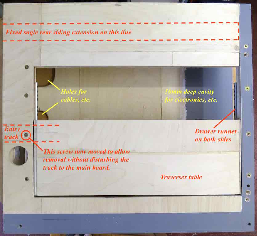

    I have been working on the two fiddle yard boards (right hand one a nominal 500mm long, and the left one 450mm) and a dismountable control 'desk'. Each fiddle yard has a drawer-like box under the running surface, sitting between the extendable drawer runners. These boxes are intended to hold dismountable structures and stock during transit. The fiddle yards incorporate softwood bearers that locate directly onto the drawer runners, and the boards are then locked into place against the main baseboard using single-hand operating ratchet clamps.

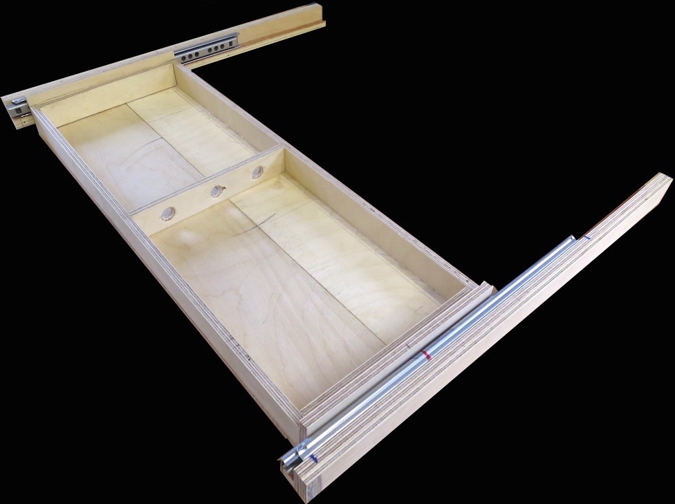

    The first photograph shows the basic box / drawer structure of the fiddle yard boards. This is the right-hand one (looking at the front of the layout); the floor of the well that carries the short cassettes has not yet been fitted. At the front corner it is possible to see the channel which sits over the extendable drawer runners.

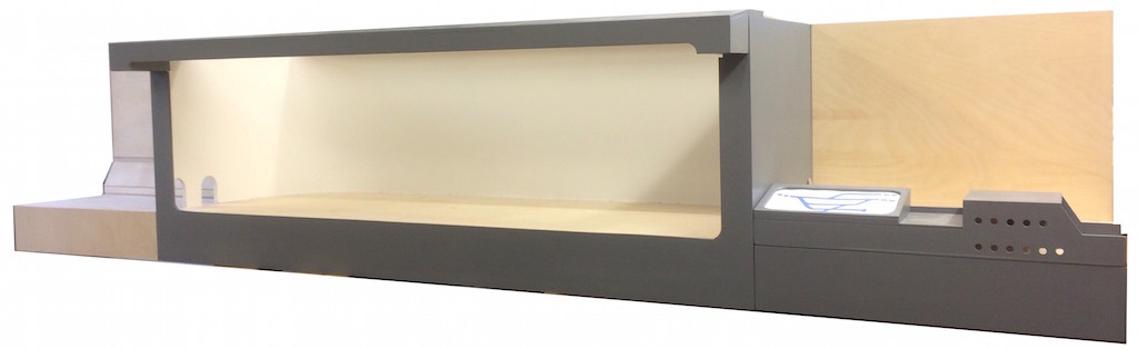

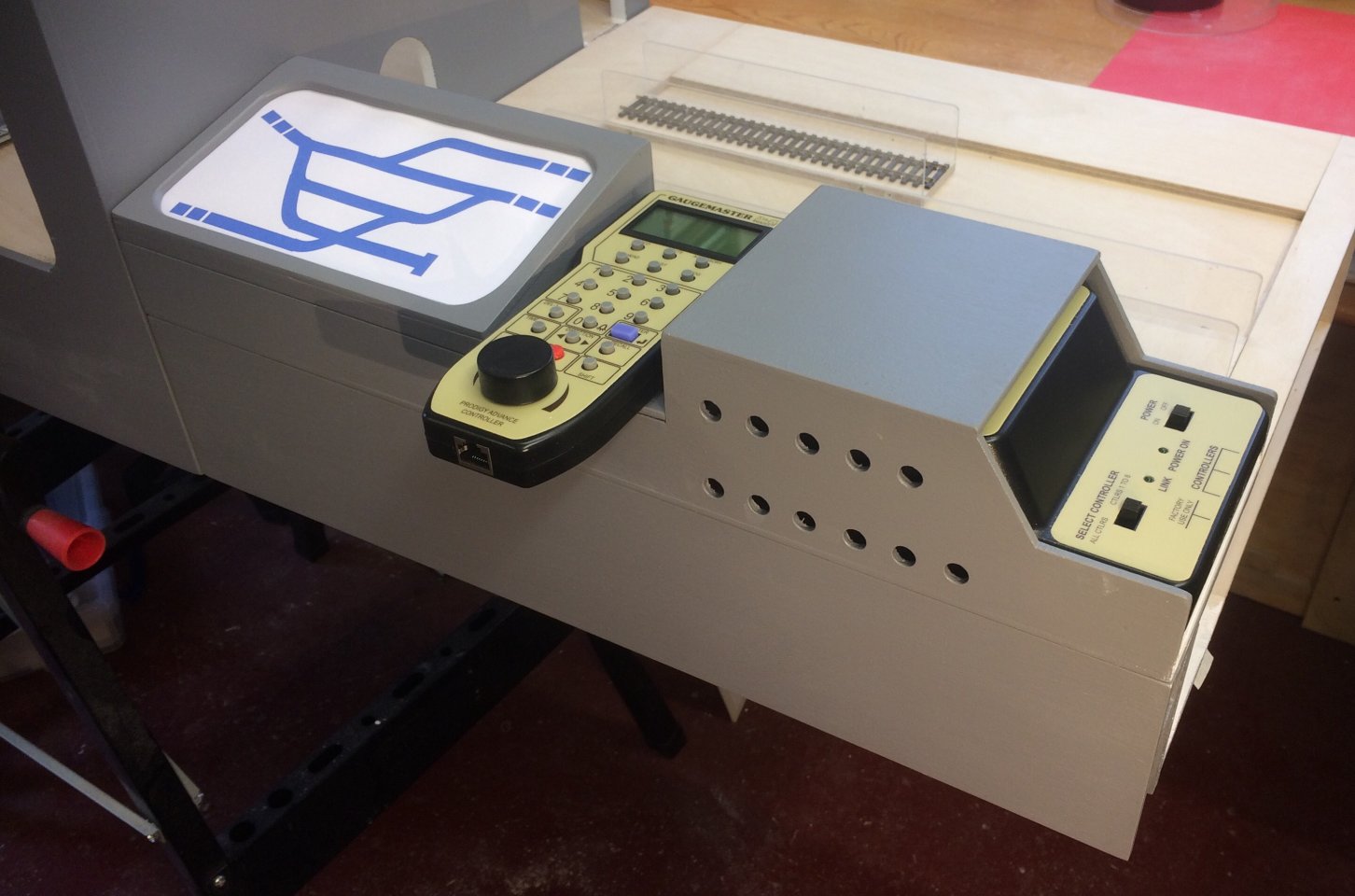

    The sixth photograph shows the "control desk"; this rather pretentious name translates as "box holding the controls for my train set", but it is a separate unit and so needed its own name. It is designed to sit on top of the right-hand fiddle yard in use and to be stored inside it for transit (the layout will be operated from the front both at home and if ever at an exhibition).
    The layout will be operated using a Gaugemaster Prodigy Advance for train control, and DCCconcepts Cobalt Alpha electronics for points and accessory control using a mimic panel with a schematic diagram. The control desk accommodates the Gaugemaster and three Alpha components - the LED switches interface, the digital encoder, and the Adaptor / "Sniffer" unit. The irregular shape of the control desk is a result of "form following function". The control desk also acts as a partial screen for the fiddle yard. The schematic diagram seen in the photograph is a mock-up.
    The dismountable control desk will connect to the layout wiring with loose cables. This method also allows for the same control equipment to be used on different layouts. The schematic mimic panel and the small shelf holding the handset both lift out to allow clear access to the electronics for programming, etc. and the schematic switch panel could easily be replaced with one for another layout. In use the whole unit is held in place with short removable dowels.
    Clearly, there is still finishing work to do on the baseboards; I also need to construct a screen / information board for the left-hand fiddle yard, and fit LED lights to the lighting gantry. I now know that the main layout structure is viable, though, and should provide a good foundation for tracklaying, DCC and actual modelling (which are, of course, the scarier parts of the project).

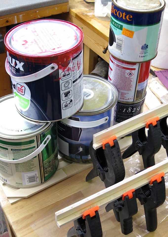

    When I worked with Paul, the Squire of Old Parrock, to design and build our main baseboards, we divided the remaining ply between us to use on fiddle yards, etc. My share of the stock is now virtually exhausted and I've reached the stage where I'm trimming offcuts of offcuts to make usable parts. Today I worked on a box structure and had to use said offcuts, one of which was a strip of ply that I'd previously avoided because it was bent. In glueing up the basic box, I had to devise a method I can only call Überclamping. Essentially I had to hold everything in alignment but at the same time hold the front and rear longitudinal pieces so that they were straight.
    I took a photograph illustrating the essence of Überclamping - holding a simple box together on its base (a 450 x 22mm footprint) required six clamping blocks fitted into the jaws of a workbench, along with a total of eight other clamps of different sorts.
    The silly thing about this effort is that the box is to some extent an experiment, and I'm not entirely sure that my projected use for it will actually work. I'm beginning to whether if I should have taken up Lego modelling.

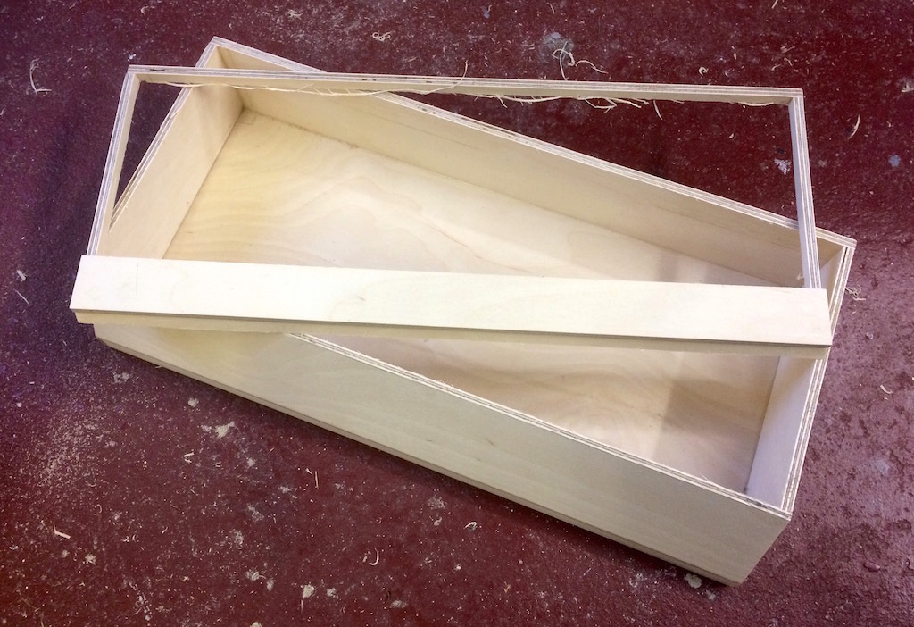

    I had to reconstruct something today, when I realised that the box I'd made to support the screen on one of the fiddle yards was too high to fit inside the storage 'drawer' for transit. Oops! Very Oops! The first viable option was to trim the top of the box to fit. Cutting a slice off the top of an already constructed box of slightly irregular shape (it has a raked front panel) was a mildly interesting challenge, but the photograph shows the result:
    The necessary adjustments are now finished with the results that (a) the box is now reconstructed for use in supporting a fiddle yard screen, and (b) it fits inside the fiddle yard storage drawer to provide storage in transit. Moral of story; measure twice and cut once ... but think hard before deciding what to measure!

    Today I was able to put all the various sub-assemblies of my baseboards together for the first time. Some of the components still need paint, but the photographs below show how they fit together. I have (admittedly rather roughly) edited the backgrounds out of the photographs so that the baseboard structure is apparent.
    Built primarily for home use, the layout and both fiddle yards will be operated from the front. The screens are intended for use should the layout ever be exhibited. Despite the unfinished paintwork, I feel that I have a viable baseboard system (scenic board, fiddleyards at each end, screens doubling as display/information panels, integral storage, lighting gantry and control desk), and that this represents my second milestone.

    I calculated that I had space to fit a three-road traverser approximately 430mm long. I wanted a simple sliding mechanism that could be fitted entirely within the existing baseboard, and be removed if necessary for maintenance, but with sufficient space beneath it for electronics.
    The traverser is a simple ‘inverted tray’ consisting of a trackbed of 9mm birch-faced ply, braced underneath with sides and end pieces. One side of a runner mechanism is screwed to each end of the traverser table. The other side of each runner mechanism is screwed into L-shaped brackets constructed from 9mm ply, which are screwed beneath the original baseboard at either end of the aperture for the traverser table, and are designed to ensure the accurate positioning and aligment of the runners. The picture below shows the runners and brackets fixed to the traverser table, thus forming an integral unit; in this view the whole assembly is inverted, as if seen from below the baseboard. The sketch which follows the photograph shows a cross section of the runner arrangement.
    Sector plate 19 - platform + brackets assembly - oblique + inverted 180508 - reduced for forum.jpeg

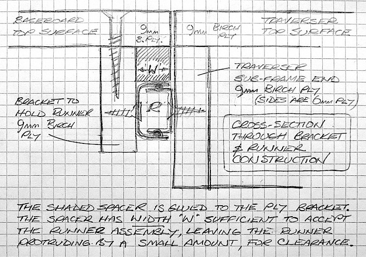

    Sector Plate 028 - fitting runners - sketch - reduced for forum - 180508 crop.jpeg
    In order to fit the runners to a plywood surface without a machined groove, both parts of the runner unit must be securely fixed at or near both ends and this required the drilling of one new hole in the part that would normally be held in the drawer groove.
    Fitting the traverser assembly into the aperture required aligning the top surface of the traverser with the top surface of the baseboard trackbed, and ensuring just enough clearance at both ends for free movment. This was achieved by careful measurement then using two pieces of thin card as a spacer when fitting the traverser into the aperture. To ensure accuracy, pilot holes were drilled for the screws through the baseboard top.

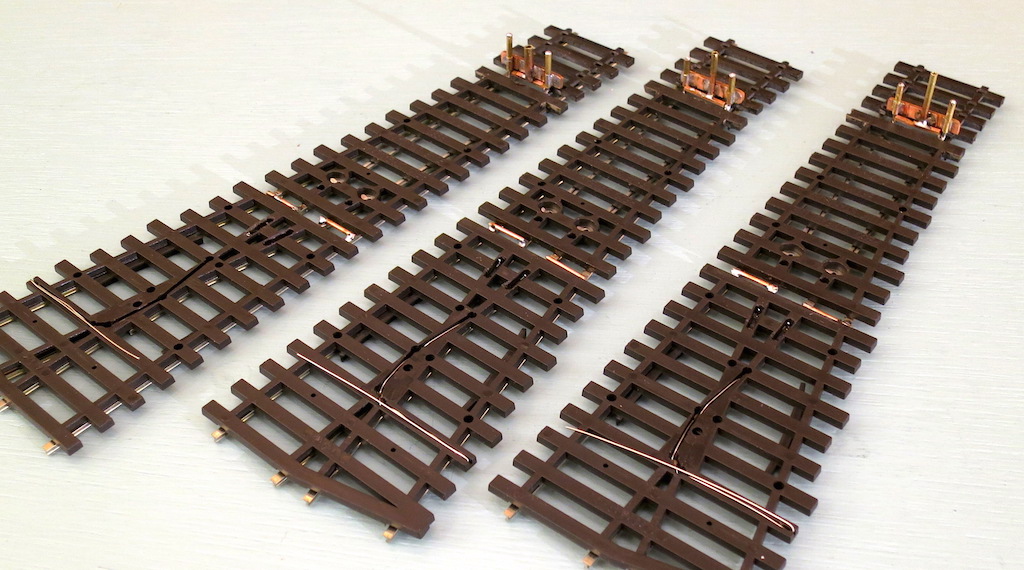

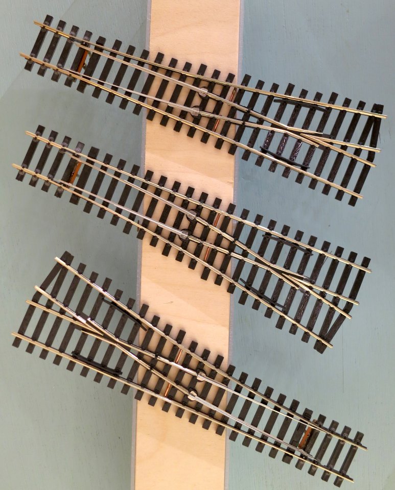

    Today I modified three Peco Code 75 Electrofrog points. The modifications are intended to improve the appearance of the points by removing the various plastic exrescences around the tiebar, and the tiebar itself. The technique was devised by Simon Cullen and described by him in an article in 'Railway Modeller', July issue 2017, pp.594-6. I'd like to record my thanks to Mr Cullen for sharing his very neat design. His method is well worth considering as a way of improving the appearance of Peco Code 75 points. The article gives comprehensive and detailed instructions, so I shall not describe them here.
    I have deviated from the original design, though, in that I have changed the way the linkage attaches to the tiebar, replacing Simon Cullen's wire loop with a piece of tube to make it easier to connect the tiebar to the actuating wire of a DCCConcepts points motor fitting in the normal vertical position.
    The first photo illustrates the intention behind the job (essentially to make the points look better) and this overview gives an idea of how the points look after modification.
    First three Peco points modified - top view 02 - 180518 - reduced for forum.jpeg

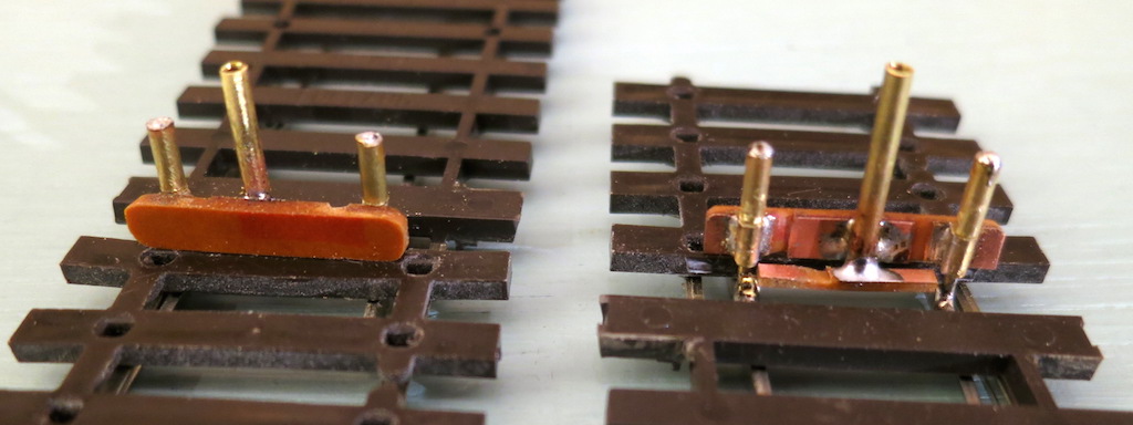

    Underneath the points the original plastic tiebar has been replaced with a new one made from 4mm scale 'copperclad' sleeper strip. The new tiebar is fitted with three tubes, the outer pair of tubes holding 'L-droppers' which are soldered to the underside of the point blades while the centre tube takes the actuating wire from the point motor. The next photos show the underside of the points and the new tiebar arrangement.
    First three Peco points modified - underneath 01 - 180518 - reduced for forum.jpeg
    In addition to the tiebar, the points have been prepared for switched frog operation.
    Simon Cullen's original design included a cosmetic tiebar made from plastic and glued to the new functional tiebar. I modified this aspect of his design when I realised that the centre tube would work better fro me, and could also be used to support a length of 2mm scale copperclad sleeper strip, soldered in place to represent a tiebar. This obviates the need for glued plastic. While the cosmetic tiebar is not a detailed, accurate model of the prototype it could form a foundation for further detailing.
    This tiebar replacement method produces points which work accurately but very freely, the blades moving easily under the effect of gravity when the point is tilted. I have two more points to modify, then I can start tracklaying. It's been quite encouraging to find that I can remember how to solder and that my modelling skills have not been lost in the wilderness years since my last (amost finished) layout.
    Richard

    Glueing underlay weighted with volumes of RM 01 180519 reduced for forum.jpeg
    I've been fixing underlay in place and needed weight to ensure it dries flat and level - if ply boards with 16 years worth of RM on them can't do that then I'm sunk. The adhesive is Evostick spray carpet adhesive - something I have not used before. I made some experiments with patches of underlay and ply, and it seems pretty effective, but the real test will be when I take the weights off. Both of the materials to be joined need to be sprayed, and although the aerosol is reasonably controllable I masked everything to ensure I could work quickly and cleanly. Positioning the underlay was 'interesting', as the glue makes a more-or-less instant bond upon contact.

    Second traverser installed and working
  • Richard H
    Western Thunderer
    After a long weekend of working on the layout, I have the trackbed laid (the Evostick carpet adhesive and the 16 years of Railway Modeller volumes did the trick. That allowed me to focus today on assembling the second traverser and modifying the existing fiddle yard to accept it. One of the challenging parts of the job was cutting away some of the internal structure of the baseboard (the part that supports it on the drawer runners) whilst leaving enough timber in place to keep everything rigid and stable. I think I've achieved that.
    Cutting the aperture was tricky enough, but cutting away sub-structure was trickier. The traverser has about 1mm of clearance beneath it and slides smoothly to serve two tracks.
    One of the things that make it worthwhile is that, although it's only a two-track traverser, one of the tracks is in a cassette, which means that this small traverser can be used to serve any number of trains. The cassette road serves the track which leads to 'the west end of the quayside' where shipyard railways produced traffic. I believe that this system will give me most of the flexibiltiy I need.
    Here's a photo of the new traverser fitted into the left-hand fiddle yard:

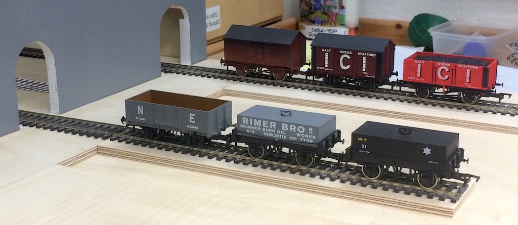

    On the up side, the track works. To get from end to end of the layout a vehicle has to exit a traverser, cross two board joints, negotiate up to four turnouts and some relatively sharp curves, pass through two narrow apertures, and enter the other traverser, one of the tracks on the left-hand traverser being a cassette.
    To give an idea of the track between the left hand traverser board and the main baseboard, here's a photograph showing the board joint, a short length of track to link from there to the traverser, and the end of the traverser itself. In this picture the cassette (on the right in the photograph) is aligned with the siding it serves.
    Traverser LH - entry to traverser 01 - cassette track aligned 180531 - reduced for forum.JPG
    The fixed track on this traverser (on the left in the photograph above) aligns only with one of the entry tracks, whereas the cassette road can be aligned with either of the entry tracks.
    The photograph below shows the same joint from the baseboard side; the wagon is on the running track and the traverser is set to align its fixed track with the running line. The track on the left of the picture is the end of the front siding, which can only be used beyond the board joint if the cassette is aligned with that track, and the photograph shows that the cassettee ia not aligned.
    Traverser LH - entry to traverser 03 - fixed track aligned - reduced for forum 180531.JPG
    The most unforgiving test I could devise to check the trackwork was to use a single, very light (and very expendable) wagon as a test vehicle, and persuade it to hurtle along every route on the layout at the highest speed I could contrive. Happily, I found that even when projected at the speed of an APT it would stay on the tracks, running from end to end of the layout and having to be caught at the end of the fiddle yard to prevent any emulation of that lemming behaviour mentioned in my last post. Not at all like the scale speed operations seen on fine-scale layouts, but great fun.

    We're entertaining friends this weekend, so the railway had to be taken off the workbench and put back in its normal habitat, and my "Light Railway Workshop No.1" was once again relegated to its less exciting secondary role as "the spare bedroom". This was the first time the layout has been re-erected after rebuilding the fiddle yards as traversers - it worked, and everything fitted as it should. I know that this is as it should be, and that there was no rational reason to anticipate a problem, but I was deeply apprehensive that I'd missed something, or made some fundamental miscalculation, or the foundations of the house had moved, whatever. Anyway, my fears proved unfounded and my sense of relief was almost as profound as my anxieties (it never quite catches up).
    Before this I had managed to determine a location for the Gaugemaster base unit underneath the baseboard and fix it in place. People who read the early stages of this blog may remember that I had made a cunningly-contrived housing for the Gaugemaster and the switch panel, which would sit on the front of a fiddle yard; this cunning contrivance went the way of most Cunning Plans when I converted the said fiddle yard to a traverser. I belatedly decided that integrating the electrics and electronics into the main board was more in the spirit of a cameo layout anyway (thereby rather dubiously reclaiming the moral high ground) and set about working out how to do it.
    Not as simple as it sounds, for the stylish Gaugemaster base unit has no fixing points, but as the operating (and relatively valuable) heart of the layout it needs to be secure and safe, and it needs access for connections at both ends. It also requires its own power source. I realised, though, that as an electronic device with no moving parts it could operate upside down, standing on its side, or even "the right way up". (This seems to work in the International Space Station, so there's at least a chance that it should be OK on a small model railway.)
    The solution was to identify a site under the main board where it was safe, accessible, and adequately clear of other structures, wiring runs or anything that might need maintenance or attention, and then to tie it in place. In the absence of fixing points, I used cable ties and cable tie mounts, like these:
    Gaugemaster system mounted under baseboard 06 - 180607 - fixings - reduced for forum.JPG
    These are readily available, cheap, easy to use, self-adhesive but with holes for a reinforcing screw, and very strong. They also, by chance, fit rather well around the feet of the Gaugemaster, which makes it easy to secure the unit against lateral movement. The next photograph below shows the base unit in place, with the power block mounted nearby using the same technique.
    Gaugemaster system mounted under baseboard 01 - 180607 - overview - reduced for forum.JPG
    The mains supply is clearly marked and 240v wiring kept as short as possible. The yellow cable is a 'tail' to connect the mains input. The Gaugemaster power source is mounted on a small ply panel fixed over the drawer runners which support one of the fiddle yards (but removable if necessary). The next photographs shows more detail of the mounting system:
    Gaugemaster system mounted under baseboard 03 - 180607 - detail - reduced for forum above.JPG
    Six cable tie mounts are used under the Gaugemaster base unit, each reinforced with a screw. The four mounts at the corners locate against the Gaugemaster feet to prevent lateral movement, and the ties are narrow enough not to impede ventilation to interfere with the slide switches.
    The building is based upon, but is not an entirely accurate copy of, the headquarters of R. Hastie & Sons, trawler owners, chandlers and fisheries. The original was built in 1913 on an irregular site to replace an earlier building destroyed by fire. The visible end of the model is a fairly close copy of the prototype and the general structure of the building with its large lift-tower is also representative, but the side walls are not prototypical, the side steps and entrance are an invention, and the entire structure is modelled as a mirror image of the original. It is constructed entirely in plastic (largely Wills' rendered concrete) with windows modified from Wills products. Parts of the building that will not be seen by the viewer are not modelled.
    Detail is yet to be added to the roof, which was used for making and repairing large fishing nets, hence the need for the lift and the staircase access to the roof - the net-making clutter will help disguise the fact that the building is truncated by the backscene.
    The lower, wooden building represents a small goods store owned by the railway company, and is a deliberate contrast to the mass of the concrete building. In the imaginary world of the Low Quay Yard, this shed is thought to have been re-built by the Blyth & Tyne company when they acquired and developed the line, the original structure having been associated with the Whitley waggonway. It is painted according to the pre-1937 LNER colour schedule. Squeezed into a very narrow site, it accommodates the limited traffic in small consignments, most of the quayside traffic actually being handled at the locations of the various industries. It lies on a siding that originally led to a boatyard, but was truncated when the boat-building ceased and now serves only the railway goods store.
    The goods store is constructed from parts of two Wills generic small goods store kits and additional plastic sheet representing the additional weatherboarding and the English Bond brickwork of the plinth. It is modelled with front and rear doors open and some interior detail (the goods inside are HO continental details left over from an unfinished earlier project.) so that the viewer can look through the shed to see a locomotive passing behind it. This is seen in a photograph taken during construction in unpainted condition:
