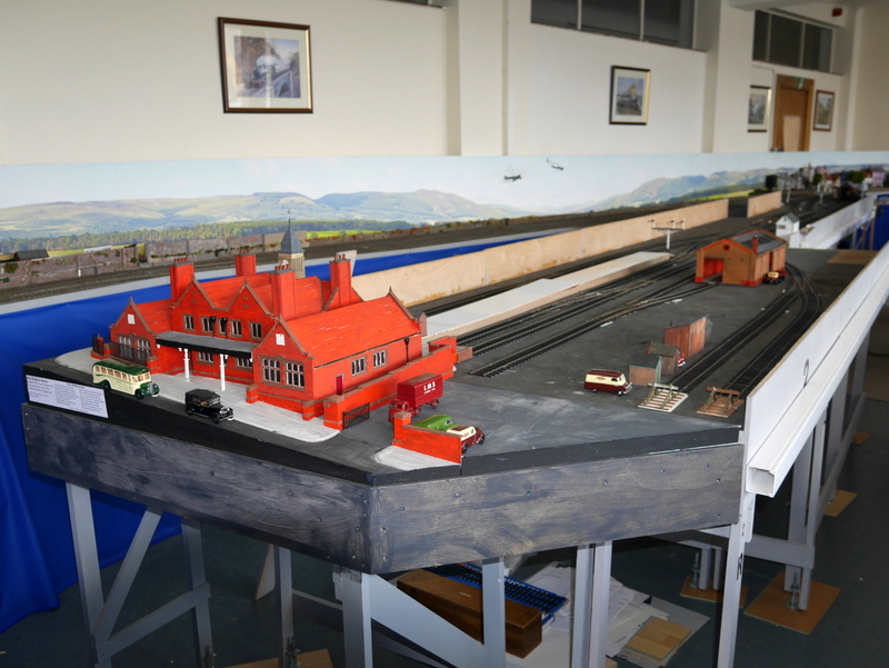

Then there is the other terminal - New Brighton.

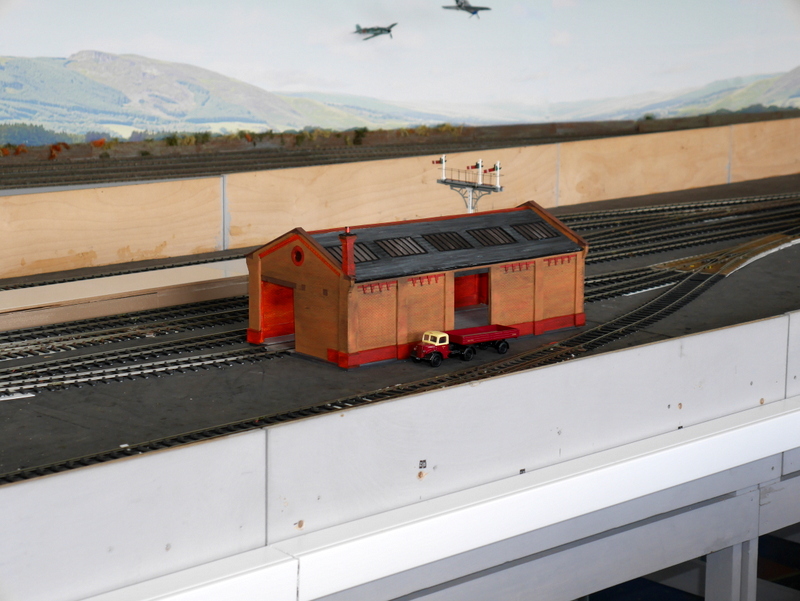

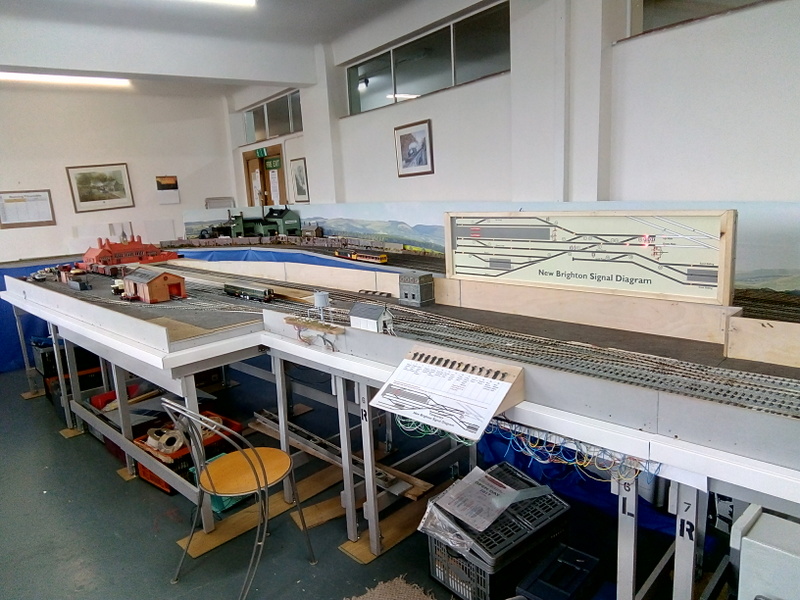

We - Wirral O Gauge Group, have just completed wiring up the layout and are installing the signals and associated control panel. The station building and goods shed have been scratch built using 'cameo cut' plasticard based on dimensions taken on site for the main building and drawings for the goods shed. Work is now starting on Portland Street bridge adjacent to the signal box and to the embankment that is adjacent to Victoria Road.
New Brighton is a 'branch' off of the DCC continuous run circuits of the Club's main layout.

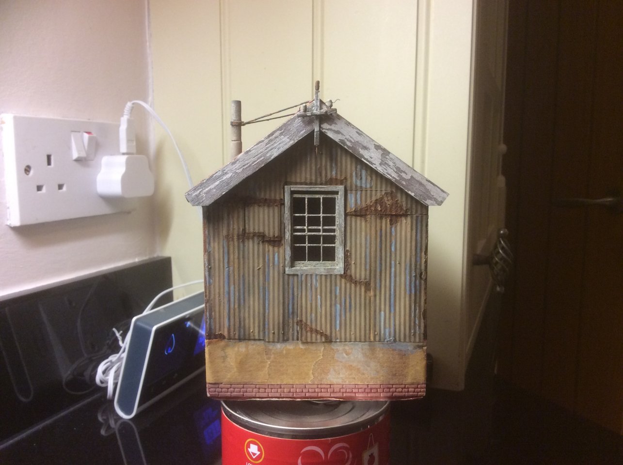

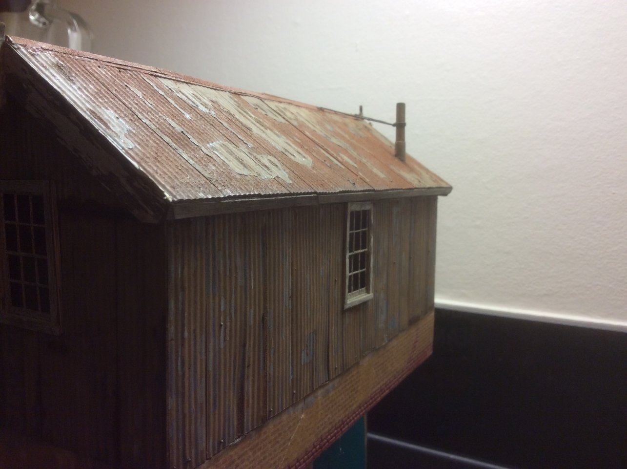

It’s a while since I updated this thread and it could be some time before a I can so again due to commitments, but I’ll endeavour to find some time.
Following my disastrous attempt at my first brass kit build over the summer, I decided to return to more familiar territory in scenic form to rekindle the mojo.
The station building - especially as it was in the senior scale and therefore the parts being easier to see - provided the ideal opportunity with which to do so, bearing in mind I’d never been impressed with the corrugated iron finish.
Following a couple of false starts, I eventually managed to make some progress, the results I’d like to share to date I’d like to share with you:
The original:
The end in the first photo:
The other:
The outer side:
Perhaps a clearer one:
The hoarding from one end:
And looking through to the entrance to the building (door required x 2):
An aerial view:
As you can tell, there’s a host of things that need to be done before it can be called anything near finished - one of the bargeboards needs repairing (the paint btw on the boards is nowhere near as stark in real life, but I’m no photographer) and the weathering, including on the roof will need revisiting. Also, the bargeboards require further detailing and the windows glazing before fitting. A door needs to be formed for the entrance to the building and the hoarding supports require an awning across the top and perhaps a sliding door. And of course, the brickwork.
As I’ve stipulated elsewhere, my many hindrances dictate that this will only ever be a nod to the original, but I’ve tried my best, and yes, it’s restored my mojo.
Until the next opportunity arises, I’ll leave it here to deteriorate further.
Thanks for looking.

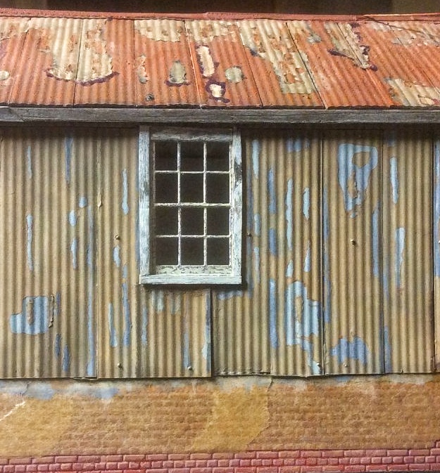

Too kind Jonte.
The overall look is spot on. In particular, I really like the treatment handed out to the window frame.
This properly looks like the primer coming through a lifting and peeling top coat.
Really top stuff and something for me to try for myself.
Thanks for the inspiration.
Rob.

I’m blushing here, Rob, as it’s quite straight forward, but thank you for the compliment anyway.
You’ve probably your own idea in mind with which you’ll no doubt do a better job than me, but if it’s of interest, all I did was take a piece of plain old, every day balsa to which I applied several thin washes of various concentrations of black paint - I just used Humbrol no. 33 Satin Black - to create the silvery grey effect of sun bleached wood. Once happy - I think 3 or 4 washed coats did the trick - I just sloshed on some neat Humbrol gloss varnish (I also had Matt varnish but the gloss was nearer :oops:) - to create a barrier between the weathered wood and the top coat. Once dry, the top coat was applied neat and in a wash of 50:50 paint to spirit/thinners, so that one area of the frame was neat and the other wash in a random sort of application, if that makes sense?
This was sealed with varnish as before, after which the final top coat was applied in the same format as the previous coat.
Give it a couple of days to dry, and then borrow one of Mrs. Rob’s emery boards to rub it down until the desired effect is achieved. I found that the thinner concentration of paint when rubbed allows you to see the wood effect through the paint, while the thicker coat gives the impression that some islands of paint have done a better job of clinging on. And of course, the bare patches of paint just show the bleached wood below. If you go too far, just apply another thin wash of black to the affected parts and all is hunky dory again. Well, for me anyway.
I used a couple of methods on the bargeboards and the hoarding supports, including this one, where I added a different coloured coat between the wood effect and the top coat to indicate previous paint jobs - in this case a maroon-ey LMS type. It worked to a degree but not to the point where I was totally satisfied. Best to just try and keep it to the base and top coat with this method me thinks.
Anyway, apologies if I’m teaching m’granny etc, and good luck!
Jonte
