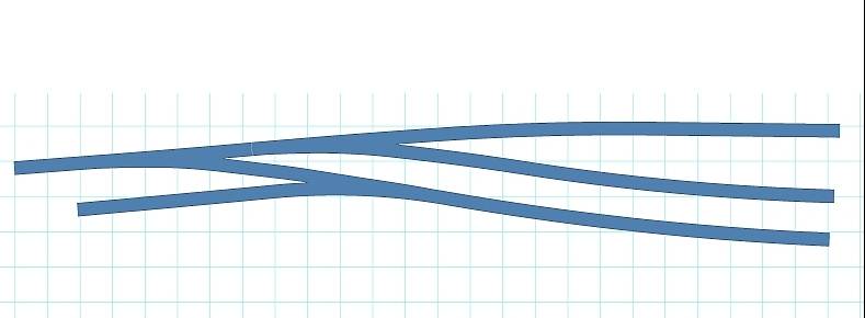

The layout design is a simple fan of sidings, with a small kick back spur. Several of the wharves on the railway didn't use run around loops and this allowed for push pull trains to utilised on the line, but some wharves were big enough to warrant more than one loco, so this design gives me the opportunity to utilise both systems.
Its P4 and utilises Exactoscale fasttrack sleeper sections and plastic timber and chairs for the 3 turnouts.
I have experimented with Radio control using the Deltang system, which I may well utilise at some point on this layout, however the size of the small locos may well mean that I stick with DCC, so the layout is being wired for DCC control. I'm not keen on having the battery for RC in a wagon behind the loco, so there's a high chance that this layout will remain DCC, but we'll have to see.
Below is a simple track plan taken from the sketchbook section of Templot. with the fiddleyard being off to the left. Probably best to add that it does have an Ian Futers flavour to it but it does fit well with the Earl of Dudley's railways system nicely.
Building has started, the baseboard is built and track laying has started too, Ill add to this thread when I next get a chance.

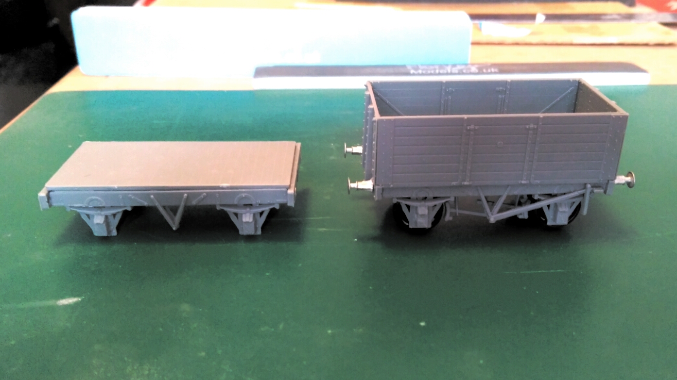

First few wagons are starting to take shape now.
A couple of Gloucester 15' po wagons a 7 plank and due to be a 5 plank. I've removed the V hangars from one side to model the single braked wagon.
Lanarkshire models wooden underframe po wagon buffers have been added and they're due to get Lanarkshire models coupling hooks too, which I think read somewhere that Dave Franks said are strong enough to be used for 3 link coupling, so not just cosmetic.
Does anyone have any recommendations for etched brakes? I have been looking perhaps at some Masokits etches but just wondering if anyone has any other ideas? Single sided brakes and just the one lever.
As these are P4 I have decided for now to just build them rigid, given a 9ft wheelbase I feel that should be sufficient and extra care is taken in aligning of the solebars.

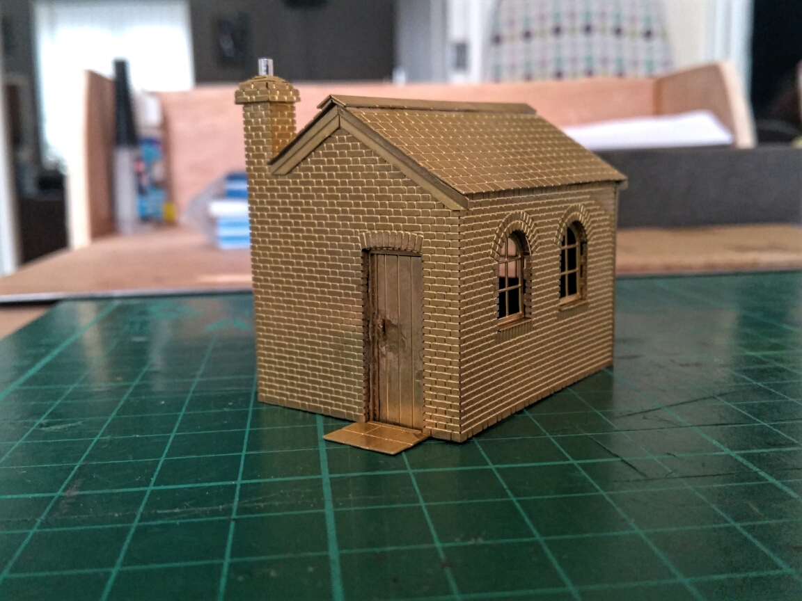

Also just with a little tidying up left to do before priming, is a Severn Models weighbridge kit. I well etched little kit and for the price a very good item indeed. The weighbridge plate also is well etched and different from the typical pooleys weighbridge. This kit represents a very early type of weighbridge which was designed with horse hooves in mind rather than rubber tyres.
The etched door handle nearly finished me off and I'm grateful for the spare handle that was part of the etch! A little tidying up of the door will be needed as even glueing with a needle tip made a mess trying to get the handle located well.
Planning on trying the new Badger stynylrez primer for the airbrush, a few people on US railroad forums are really taking to it, even covering brass. It's designed to be sprayed from the bottle without thinning and is self levelling, so that'll be the next update on the weighbridge.

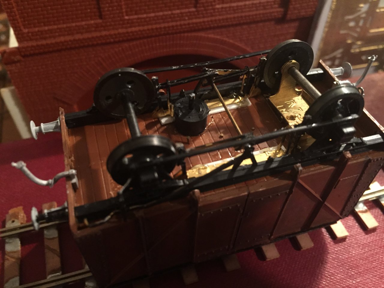

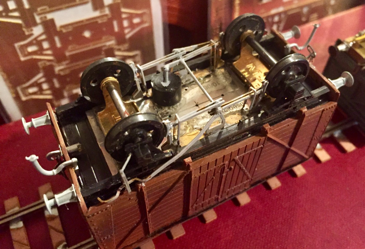

Here’s two 1/108s I made earlier with Bill’s bits. I must get back to them.
Cheers
Jan

Hi Chum,
For me, there are no daft questions.
The etched chassis is one of Bill’s:
It comes with springing. As to whether it works - well, there’s definitely (even if I build it..) some cushioned movement in the vertical plane, so I would say yes. However, the springing is 11 thou guitar wire, and I have to use latex gloves to stop it going rusty. So - for me. - it’s not optimal. It DOES reduce wobble, but having correct clearances in your crossing is prime, for me. Which is why I P4... I like Lurchers, but only in canine form....
Bill’s etches are well thought out and easy to understand. There are no instructions for the chassis - there are some for the springing units - but the chassis is a reasonably intuitive build, so I don’t think any are needed.
The chassis is an excellent fit on the Bachmann body. All the extra whitemetal bits are from Dave Franks.
I do use compensation as well...
This is the ‘standard’ - one axle fixed - configuration, using MJT Inside bearing rockers - very handy for RTR conversions, in that you keep the connection between the moulded solebar and springs. I’ve done something very odd (purely for my own interest) on this one...
This uses a Palatine Models baseplate with MJT Inside rockers on both axles... It seemed like a fun thing to do... if you use internal rockers, you’ll have to file the pinpoint ends of the axle, which means you’ll need a jig to hold the rocking axle parallel to the fixed one for maintaining squareness..
I haven’t done coaches... too many windows.....
Cheers
Jan

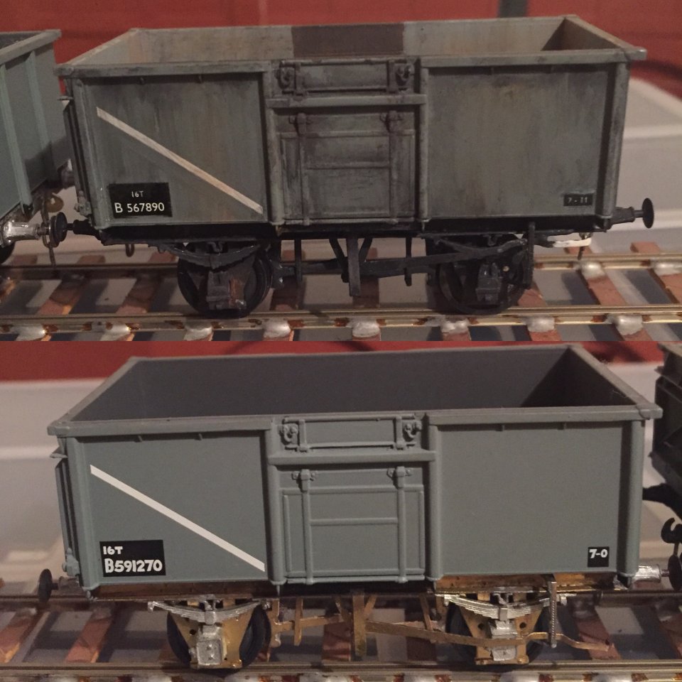

Are you leaving the brake lever down/on on that second mineral wagon? Not often seen modelled.
Hi Dave
Thanks. I’ve made it so it pivots.
The joy of the Craig Welsh lever guards is that - although they’re a terrifying exercise in pan-dimensional origami - they allow free movement of the lever. And - as you say - a dropped lever is seldom seen (but required in the prototype ) . So I thought I’d give it a go.
