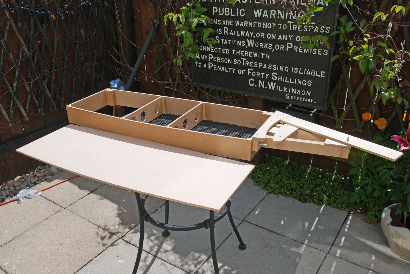

1. The basic baseboard with fiddle yard attached. The solid top has not yet been cut to shape. It will be screwed in place. Do you like the trespass sign? I used to model the N.E.R.

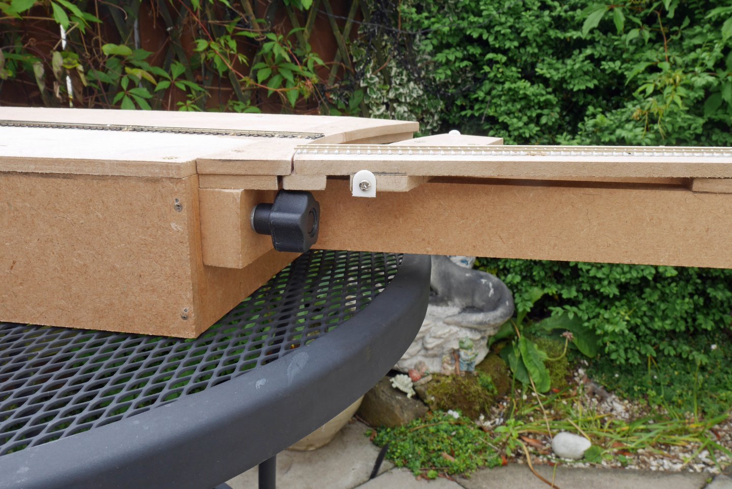

2. Closer view of the sector plate fiddle - a very simple affair.

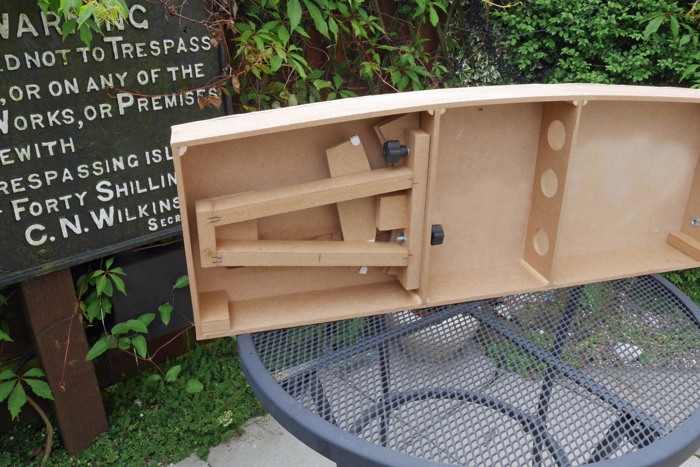

3. An underside view showing simplicity of the sector plate construction and illustrating how it sits neatly within the body of the baseboard. Yes, the baseboard top surface has been cut to shape and screwed in place at this stage.

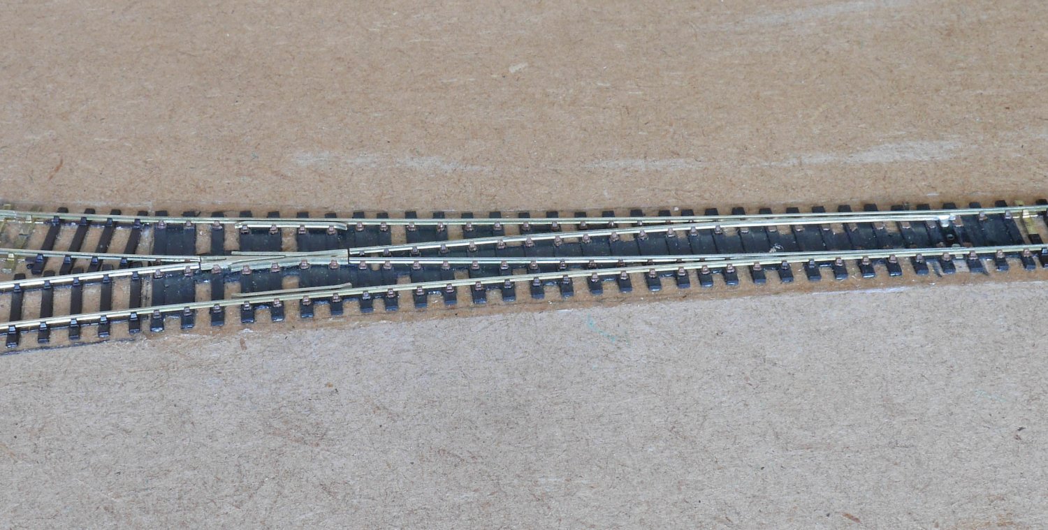

The common crossing is milled from a single piece of nickel silver and greatly assists the novice builder. The chairs appearing to support the crossing are just plain Easitrac chairs i.e. not the pegged variety, which are simply cut in half and glued on to improve the look.

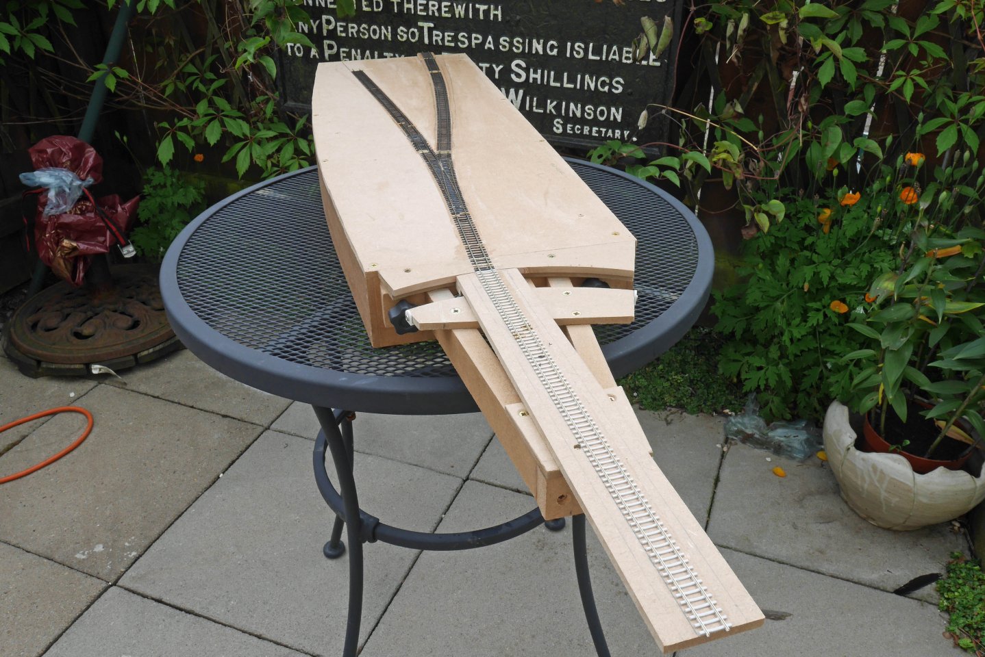

A little update, below is a picture of the single turnout which started life as a right hand B7. It's possible to make out the beginning of my first working trap point, of which more anon. The bright coloured sleepers are brass castings used to supply feed to the rails. Just below the switch a large hole is where an electro magnet will be positioned for uncoupling using my now standard Electra Couplings designed by John Whitehead around 1979.
Below we see the public part of the layout in the raw.

And below the devilishly simple means by which the track is held level between sector plate and layout proper. Later on I'll show how the tracks are aligned to allow running across the joint.There will be another line laid to the right of the main line (which is to the right in this view) but this will be a hidden fiddle siding, also accessed from swinging the sector plate.

Love the track arrangement, Mick; simple but sophisticated!
Intrigued by the sector plate, too. Would like to know all about its construction (if you have time, of course).

Jonte,
Thank you.
I will be writing up the sector plate but in advance of that can I say I consider this a 'lash up', it's so simple and relatively rough. The key part is ensuring the tracks stay in the same plane and that can be seen in the side view picture above. The alignment is just a hole and peg system and your own thoughts are just as good as anyone else's.
I will get round to it though.
Mick

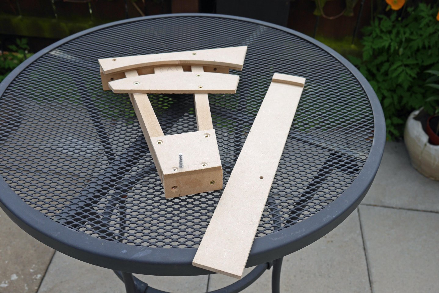

I'm back again and would like to show how things are progressing. With the attempt to illustrate so much in so small a baseboard things inevitably will get to a stage where they look over busy so we'll start simple...! Below is the baseboard underside with the 'bus' in place. I'm making an assumption here (always dangerous) that everyone knows what a bus is. If not shout up...! To the right side can be seen a servo mounting and an electro magnet. In the middle - a piece of aluminium 'U' channel that will hold the servo that actuates the trap point. At each end of the board you can see I have clamped pieces of mdf, using 'T' nuts, that allow me to invert the board without running the risk of damage to the topside.
Just a few words here about the servos; these are standard items bought via the Internet for less than £2.00 each but with the electronic components removed, leaving something that might best be described as a motor and gearbox inside a servo casing. This is not my idea and I am grateful to fellow 2mm Scale Association members Bob Isgar whose idea I believe it was to rip out the electronics from the servo, and David Long who pointed me in this direction. It is however reasonable to add in here that since there is nothing new under the sun this might not be a new development so apologies to anyone who thought of this earlier and is not being credited here.
What needs to be done is the electronics, in the form of a small circuit board, need to be removed completely and two new wires soldered to the poles of the motor. You're exactly right "thez nee pictchas of the sorvos gutts" (there are no photographs of the servos inards)
The wires are run off from the servo unit and connected to a supply which can be something as simple as a 1.5volt battery via a double pole double throw switch. The centre terminals of the DPDT are connected directly to the motor and the outer terminals connected to the power supply. One pair have the polarity reversed which simply means holding the switch over in one direction powers the motor forward and in the other reverses it - really simple. The power in this instance is a plastic case containing two AA batteries as seen in the picture below. Little cases like these can be bought for under £2.00 from the electronics dealers who ply the model railway shows. They’re also obtainable on the High Street where you might pay a little more for them, but still not very much. I have some which will hold one, two, four or eight batteries which will provide me with 1.5v, 3v, 6 v or 12v. Because a bias centre off switch is used it is simply held over one direction until the motor stalls at which point it is released.
Whilst making the servo operate in the way it does is definitely not my idea I may have individualised the way it operates the piano wire shaft that moves the switch tiebar, because it is this aspect I have not seen before. The two pictures below show what's happening I hope, in the time honoured 'spot the difference' style. This servo is in fact the one operating the trap point and has the micro switch for the one and only point on the layout (did I say layout..?) ganged in. I have some pictures of the 'cobble up' that is the micro switch mounting but it's reasonably obvious what is happening from these two shots.............oh, alright then, I'll explain.
I am using the full amount of travel the servo has to offer; there’s no electronic servo controller at all, it’s all really simple with about 75% - 80% of 360 degrees being travelled by the servo arm. Switching power on simply sets the motor running and when it reaches its own limit within the casing it stalls, the DPDT switch is released and the switch blades are held over because the low gearing within the servo act like a spring - job done. Also to be seen in these views are what I think is my own take on the switch actuating rod, a length of 0.6mm piano wire. People normally make a Z bend of sorts with the operating wire which is fed through one of the holes in the servo plastic actuating arm and use servo controllers to restrict the amount travel. If the Z bend method were employed here the actuating piano wire would protrude above the tie-bar into the scenic area every time the switch was thrown then fall back to the 'at rest' position when the servo stalled. A separate piece of scrap brass is used as a fulcrum (seen in the picture) through which the piano wire passes. At this point there is a piece of mercontrol tubing soldered above and below the pivot point preventing up or down movement when the servo arm rotates. (otherwise the piano wire will fall out…!) It is feasible to drill a hole in the aluminium ‘U’ channel to use as the fulcrum but I decided against this because it’s easier to thread piano wire up through the hole in the turnout tie bar and fix in place if the servo and ‘U’ channel are separate entities at the time.
