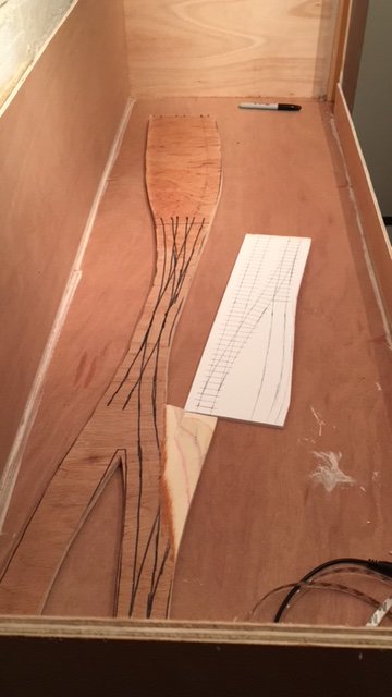

Now, onto the layout - from the outset I wanted the layout to be a little different, portraying a run down industrial scene in an early 1970’s winter. If possible the industrial railway would be supplemented by some BR action, but only if it didn’t result in things looking too cramped or too much compromise. This concept developed into an early plan for a small set of interchange sidings half way along an industrial line, with a couple of sidings serving various steel works buildings. A scale plan of this proved it fitted although somewhat cramped, into the 5ft space I had given myself to work in.
The only flaw with this was that upon measuring the car just prior to constructing the boards, it became obvious only a 4ft 6in board would fit, and as such the baseboard was built to this size - I certainly didn’t want to go down the van hire route for something no more than 10ft in total length, and this seemed to undermine the cameo concept somehow. Putting the plan onto the shortened board did not work at all, and it was back to the drawing board for a rethink.
Several ideas, geographical locations and plans later I finally found something I was happy with and seemed to offer sufficient operating potential. This is key to me getting any enjoyment out of operating, every movement must have a purpose and be carried out in a prototypical manner - you can’t run a ‘coal train’, but you can run 8M27, the 13.27 loaded coal from A to B.
The original plan had gone under the working title of ‘Bottom Works’, representing the lower half of a steelworks complex, and identifying the layout, hopefully, as being set in Yorkshire. I was keen to keep this name going but as the new plan no longer featured any works buildings (a cameo sized baseboard fills pretty quickly when steelworks buildings are on the agenda!) I added sidings to the name, what is modelled supposedly being the one time junction for a line serving a plant at a lower level.
I think the finished plan is a bit of a cross between a layout in its own right and a ‘bitsa’ - while it doesn’t try to portray a small part of a larger scene, it is totally reliant on the imaginary scene around it to work, so what am I modelling?
Towards the rear of the layout there is a freight only branch running from a set of exchange sidings to a small steel processing plant (the exact specification of this and the traffic it creates is still TBC...) This is maintained and operated by BR, with BSC movements having running powers. Mid way along the layout this connects with a BSC internal railway system serving a secondary entrance to a coking plant (assumed to have originally been part of the steel companies property portfolio) and there are a couple of loops for the interchange and holding of traffic. There are then a couple of sidings and a lifted line, formerly heading off to the previously mentioned Bottom Works (another area of the former steelworks). The whole concept is heavily inspired by the Stocksbridge Railway. Hopefully this overhead shot from before too much had happened gives an idea of the plan:

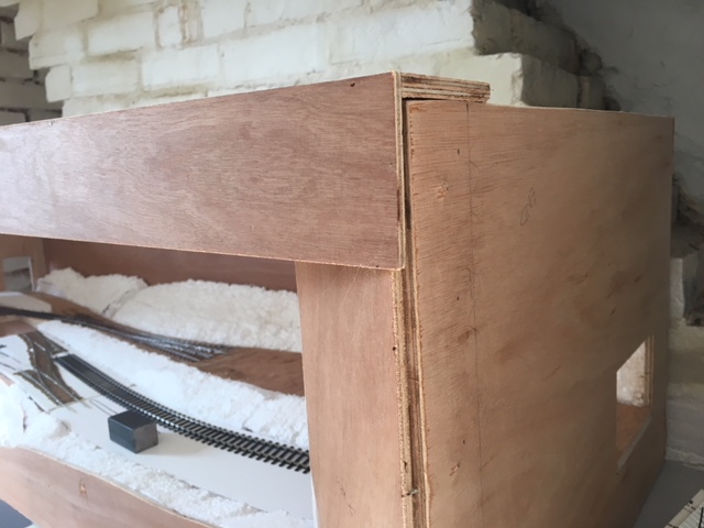

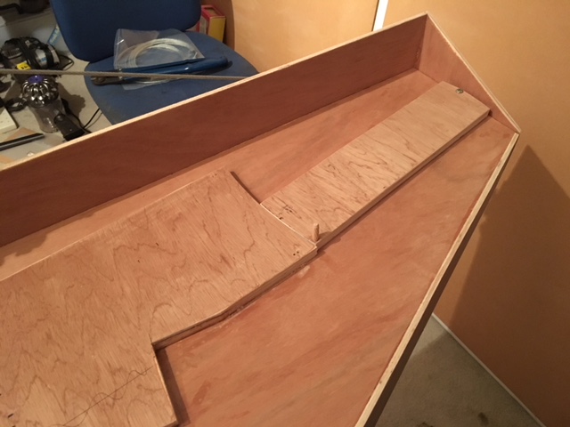

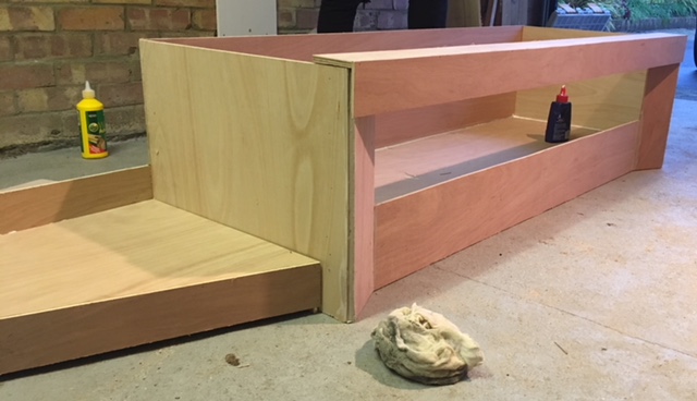

There is nothing special about the construction methods, the boards are a mixture of 6mm and 9mm ply - I’m certainly not a carpenter and as such the boards are a long way from perfect, but will hopefully do the job. (I didn’t want to end up restricted by the constraints of an off the shelf kit board, and was keen to follow the advice of Iain in the book with all the board components built in from the start.) In hindsight I wish there was a bit more 9mm in it for some added strength, but it is nice and lightweight... the lighting pelmet is removable at present to ease construction but is intended to be semi permanently attached upon completion - at present, my initial experiments with LED lighting haven’t convinced me this is the way to go and I may install a fluorescent tube if I don’t have any more luck, but we will see.
A nice cold day for Oly and myself in November was spent putting this together...
A bit more work and the front facia cut to shape - someone stole a chunk out of the front!!

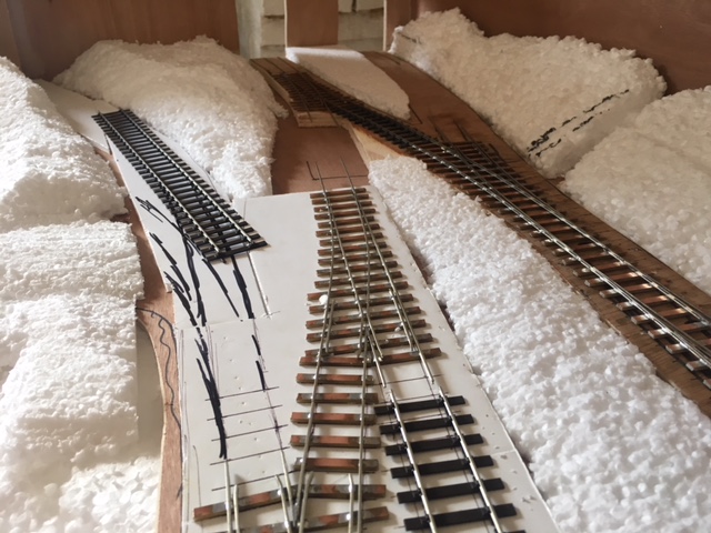

I’ve built the pointwork up from copperclad and code 75 BH Rail - I wanted to ensure the trackplan flowed through the layout and there were no lines running in straight lines parallel to the board edge. It’s intended that the left hand fiddle Yard will be cassettes whereas the right hand end will be a small loco release traverser.
Thats about as far as things have got so far, I'll soon be setting too on the topography with plenty of papier mache or filler, and have already started putting a few scenic features in place, such as this groove where a stream will descend a set of steps to reach the culvert that will pass under all lines.

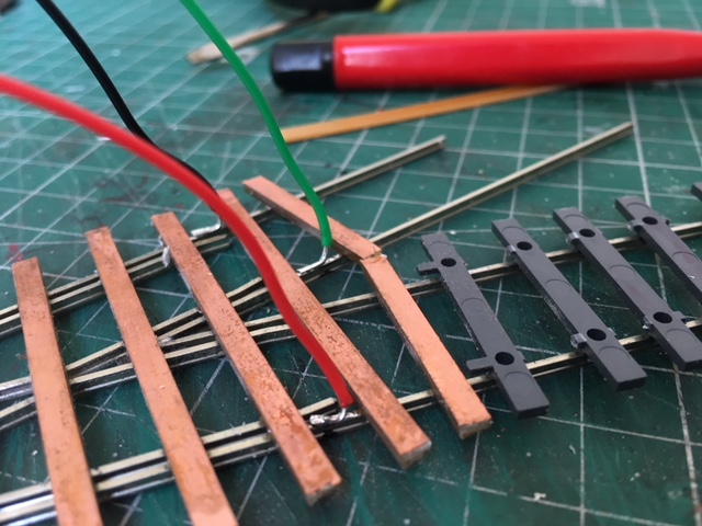

First up I finished the points by adding tie bars, I had utilised a couple of spare half hours in the week to get the sleepers gapped, so just some filling to go.
The tie bars are a bit coarse but should hopefully be robust. In future on a 'mainline' layout I'll look into moving the tie bar under the baseboard I think, but here they will be pretty buried among the muck at track level
Next up, and keeping the soldering iron warm it was out with the wire to start adding droppers to the underside of the rail prior to installation. Nothing complex here, the layout will be DCC operated so a wire to every rail and one to the point V's (in a noticeably different colour to pass my idiots guide to wiring things up the wrong way) is all that is needed...

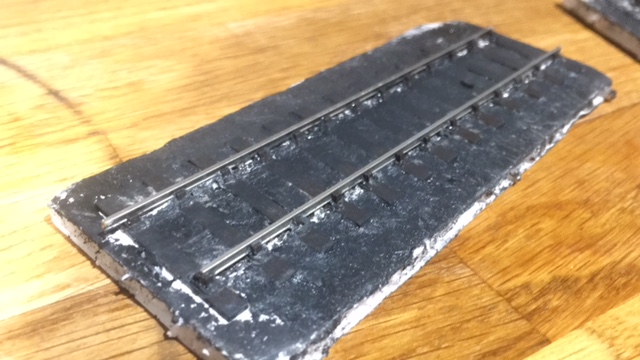

With the two main points in place, it was onto the plain track which is C&L flexi. I have however modified this by removing the webbing, hopefully worth the effort, especially since the ballast is intended to be less than perfect in the yard. I can now spend the next couple of months recovering small bits of black plastic which have fired into every corner of the loft room!!
So far I've only managed to get the three main sidings down, held in place with a thin layer of Tommy Walsh's finest quality Poundland PVA (which is actually pretty decent I find). This will obviously be strengthened when ballasting commences.

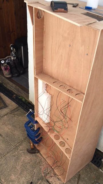

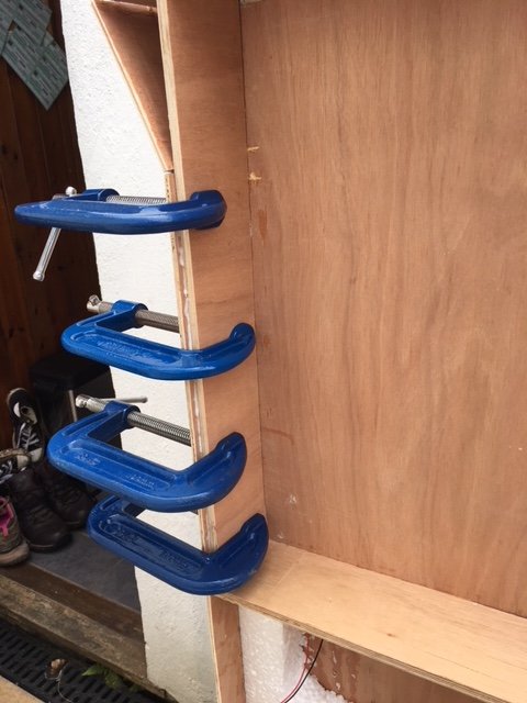

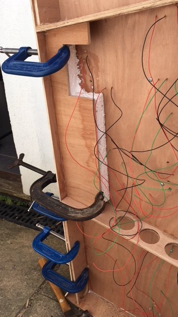

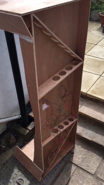

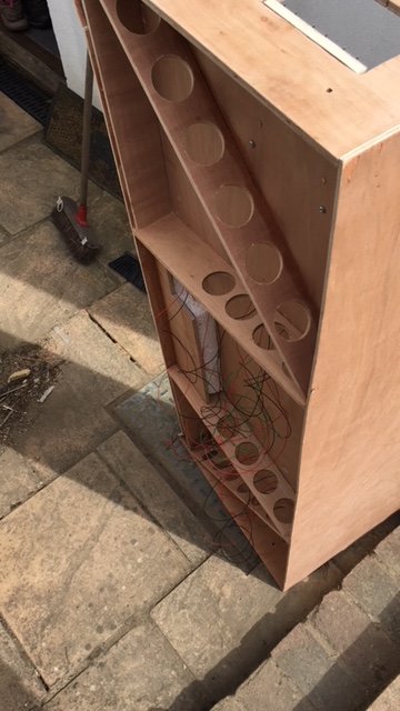

When I first built the baseboards, I went for a very lightweight design, and followed the Rice ‘monocoque’ principles touched on in the book with the front, end and rear boards forming part of the frame and therefore being integral to the baseboard, rather than being added onto a self-contained board. However, I’m definitely not overly skilled when it comes to woodwork and with much of the board being made from 6mm ply I had decided that things were a bit too flexible and wanted to add some strengthening before going much further – in future I’ll use much more 9mm from the outset to minimise the amount of extra framing required, but this was a good opportunity to experiment on a self-contained baseboard and see how light things could be.
Anyway, last weekend I had the first opportunity in ages to get the baseboard outside and do the necessary woodwork to sort things out. As it turned out to be a lovely sunny day this also involved getting sunburnt but I guess that is all part of the experience! BWS now sports some additional diagonal framing between the already diagonal cross members to offer some more support, and the facia has been improved upon with some new woodwork to the rear ensuring all is held together tightly. While I was at it, I got the hole saw out and went a bit mad chopping bits out of the framework, deciding that I should keep weight to a minimum – I think this was a worthwhile exercise, and it has made it look vaguely professional underneath… (looking and being are both very different things!)
New front strengtheners being added...
That vulnerable bit of polystyrene has been protected
New undersides in place!
Mega weight saving!

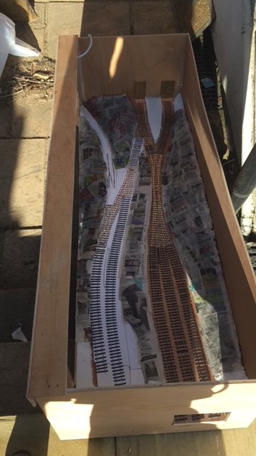

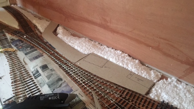

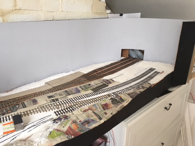

Track laying has continued on the front sidings, with now just the kickback to install – this will be laid in code 55 flat bottom rail as it is supposedly the stub of a long since lifted line, and to create a bit of a talking point.

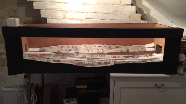

I’ve also had a chance to get some papier-mache onto the polystyrene formers for the landscape, which I didn’t find particularly satisfying – in future I will revert to a layer of filler as I have always used before I think, but, as I said earlier this is a good opportunity to experiment with 'new' (well since primary school!) techniques. While I was doing this I was struggling to get things to look natural and as a result the stream running across the layout has been filled in as it did not work with the flow of the landscape, I am much more comfortable with how it looks now although a little further work with mocking up some landscape is required I think before things are finished off.
Finally, while the layout was outside, I took the opportunity to get a first layer of black paint on the frame – this will need a second coat to finish it at the end but I have found it makes a massive difference to the appearance of things and should help to be able to visualise how things will look as the scenery is installed.

I had been planning on using LED strips to light the layout, and to this end had purchased both blue and cold white strips to experiment with. However I’ve not been able to get a balance I am happy with, most giving a lighting tone far too intense for what I want to represent a cold overcast winters morning in Yorkshire...
Therefore, in a slightly retro step, I’ve invested in one of these:
Which is now fitted behind the pelmet and wired up - being a low wattage this gives a far more balanced light over the layout and I feel much more comfortable with the results.... here are the old LED’s being pulled out in favour of the new strip light:

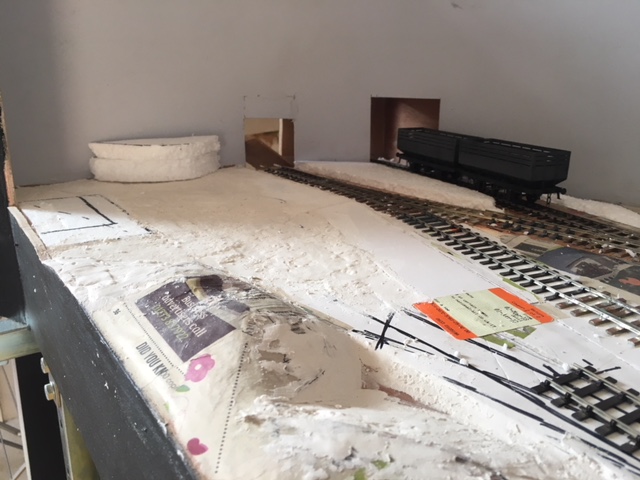

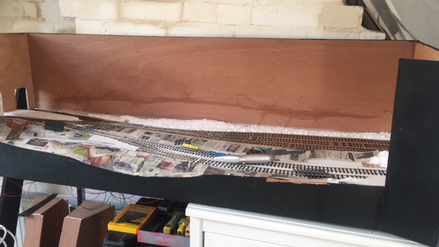

As part of this, I've added a roadway to the rear of the layout, which has principally been made from MRJ envelope cardboard - a frame being built up as a set of foundations and then the road bed being added on top as suggested by Gordon Gravett. Although I intend this to be no more than a loose ash road, I took care to add a slight camber and then spend a considerable amount of time smoothing the curves and gradient changes out with filler, the end result I am pleased with so far.
I intend this road to serve a small crew room alongside the loops, and with an assumed fairly gentle pace of life on the line this will provide some extra movements as the loco runs over and sits outside while the crew have a brew... an idea pinched straight from Hywel Thomas' Morfa Bank Sidings!
You can probably also see from the above the back scene has appeared, this will however be changing colour shortly as I am not satisfied with the shade!
At the front of the layout there is a coal yard going in where once there was a Hill - now an effect of making things a lot flatter is the difficulty in blocking view lines to the holes in the backscene. I think through a combination of a building, a stack of coal, a wagon and a couple of bits of industrial detritus I have managed to cover the left hand end, but we need to get a bit further to confirm things....
The siding that serves this coal yard is planned to be little used, is steeply graded and in a pretty poor state of repair, the sleepers buried in muck. To help this impression on its way, I've layed the siding in code 55 FB rail which will hopefully be quite effective.
All the scenery is now covered in a hard shell with a base coat of paint and things are starting to look a lot more complete. Now that the weather in the south east has cooled down a bit, the next job is to get everything wired up and working, then carry out some thorough testing. The thought of a session in the loft with a soldering iron in the recent heatwave was a bit off putting hence the progress above ground level! I have however done a very rough and ready test piece which has been deemed a success and the technique will be developed in practice somewhat more neatly!

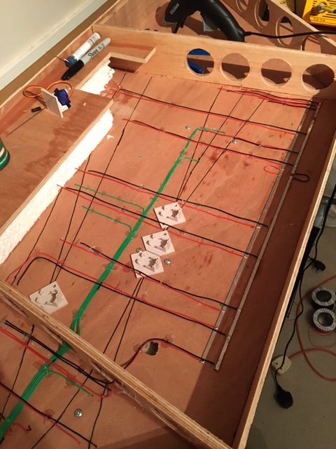

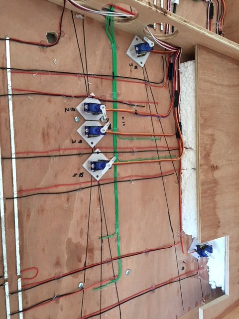

There hasn’t been a huge amount of visible progress above the baseboards since my last post – things are now at the stage where I can’t really go any further until I’ve finished wiring and been able to give the layout a full shakedown and simulated exhibition operating session to try and identify any issues that need ironing out before I set the track permanently in place.
I have, therefore, been busy with the soldering iron and glue gun under the baseboard wiring things up – so far I have put the main bus wire in, which uses sections of copperclad strip glued to the underside of the board in appropriate places linked together and to the controller, and am running wires to the switches that have now been mounted in the left hand facia panel.

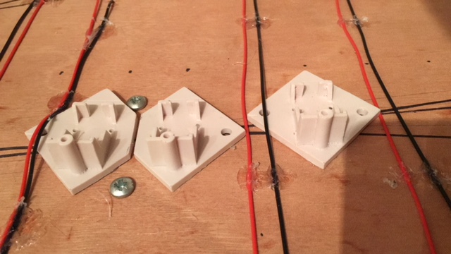

Point control will be by way of servos, I was going to go with Tortoise motors but as I has a selection of bases and servos already in stock that had been intended for a previous project it seemed a logical way to go, especially as I’d need the control board for signals anyway. The bases came from the States a few years ago (back before servo control had taken off here), I think they were from Motrak Models, and are lovely and simple!
A Megapoints controller has also been purchased and I am in the process of mounting and wiring this.
I’m hopeful I will get all the wiring in place and the layout up and running in the next couple of weeks, it will be good to get some trains running at last!

The servo cables not connected to anything at present are in place ready to be hooked up to the signals, which Mark Tatlow very kindly volunteered himself to build (before realising what I wanted!) - having seen some photos though they will be the best bit of the whole layout...

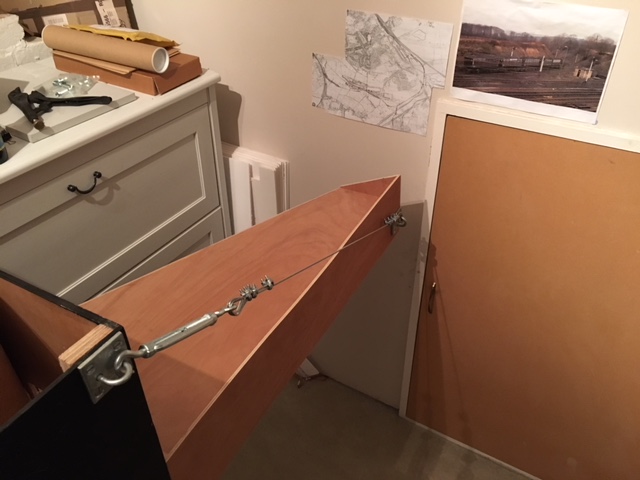

At the weekend I finally got the opportunity to get the stoarage yards at each end sorted, a job I’ve been putting off for ages. Inspired by my friend Andy Jones’ solution to supporting the pelmet on his ‘Tarring Neville’ layout, and Mr Rice’s comments in the book, I thought I’d try a suspension method rather than a leg for support, therefore providing more flexibility with display height, as the scenic section sits on adjustable legs.
I’ve used a metal wire kit which comes with everything required, and mounted it so that the stoarage yard hooks onto the top of the layout structure. The hook is adjustable so once in place can be tightened to the correct tension.
The left hand storage yard seen above is a very simple affair. No wiring is in place as this will be cassettes and they overlap onto the main board, again as per the suggestions in the book. I need to do a little more sanding across the board joint and build some cassettes but otherwise that was a nice quick win!
At the other end things are a little more complex, with the 3 loops on the scenic section ending in a sector plate for loco release. Now that the board is mounted to the scenic section I now need to paint the yards before I can start work on laying the track here, then I’ll be in a position to have a proper shakedown operationally prior to starting any scenic work that goes near the track!

Everything is looking nice and neat. I like the simplicity of the suspension fiddle but not had the opportunity to try it in 2mil yet...!
Mick S.
ChrisM
Active Member
Thanks Mick, I expect for a small size 2mm layout, you'd barely need any form of suspension, but it would probably work quite well for a medium sized layout!
Not sure how long you could realistically make the suspended board while keeping the anchor point within the layouts main structure - I think if you went much more than 3ft you'd need to start looking at quite a complicated and ungainly setup...
Chris

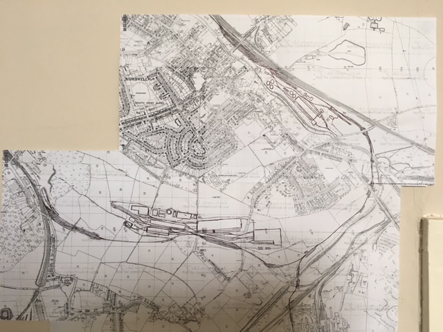

As part of this I've drawn the line onto a period map, to give an accurate idea as to the location:
The line curving across the lower left of the map is the Midland line through Wombwell station, Hill that diagonally crossing the top of the map is the GCR line through Wombwell Central station.
A close up of the coke works section of the map, with the small section portrayed on the layout hopefully visible.
