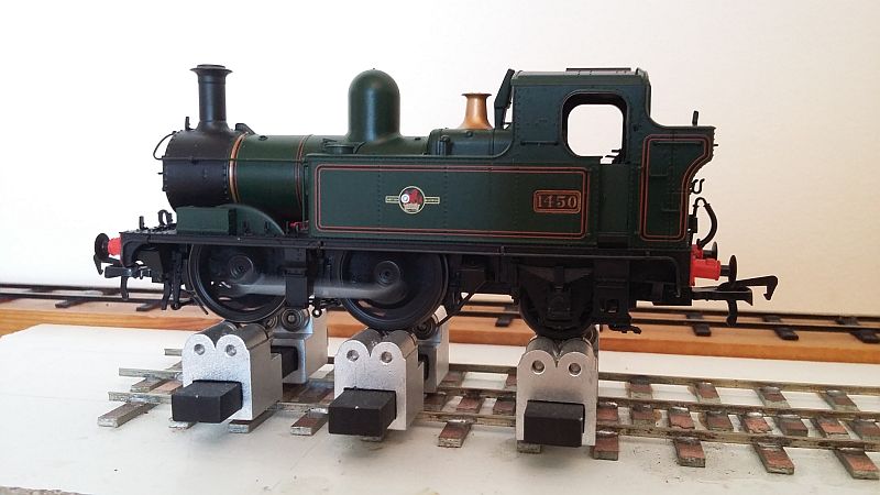

Meanwhile, the 1420-to-be is getting some more hours in on the rolling road:

Well, Rob, what can I say?
Perhaps you could forsee that I would finally run out of patience with the Hattons 14XX mechanism. After further running in this afternoon, it actually ran worse than it did before, just like the first example I had from them, before I sent it back and got this one.
Enough is enough.
As I've posted on the Hattons 14XX thread on RMWeb, in due course I shall remove the Hattons chassis and all the permanently-fixed internal workings, leaving the lovely body shell only. I shall then build and fit the Perseverence chassis kit that I have and consign the Hattons/DJM mechanism to the place it belongs - the skip.
