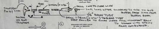

The instructions to build the buffers. Adrian B. Swaine (ABS) often expects you to “scratch” build components although this is easier than it first appears. I have already countersunk the buffer housings almost to the buffer plank face with a 1.7mm drill in a pin chuck. White metal drills easily so gently does it and keep checking. It’s easy to drill a bit more but difficult to put it back. Adrian was still an active modeller at 90 years of age.
